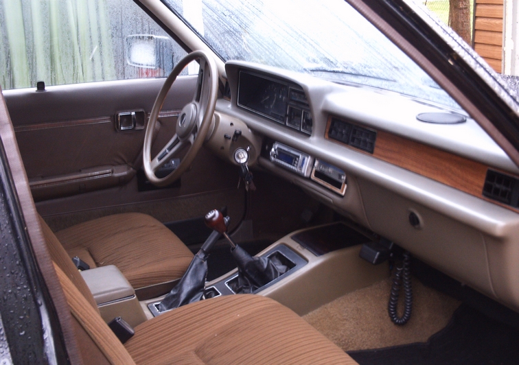

| The original dash in my white 929L - no clock, no tacho, only AM radio. I changed the original burgundy coloured steering wheel to a Cosmo/RX5. It looks so much better.  The modifications begin - i removed the clock and fitted a factory tacho and digital clock from an S2 929. I also changed the fuel and temperature gauges to S2 specification - I like these better.  A genuine Luce hand brake lever now fitted to match the steering wheel.  The latest modification - factory Panasonic stereo and cassette  | |

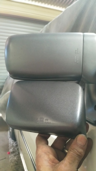

| Another modification i have made recently. I now have S2 929L electric mirrors. In Australia, our S2 came with chrome exterior electric mirrors. I removed a wiring harness from a wreck and modified to suit my car, and fitted the driver side and passenger side door internal wiring harness. The plugs for central locking and electric windows are also part of this harness - I may fit these later because I have all electric locks, motors and controllers. The original manual operation door mirror:  One of the forum members was wrecking his silver 929L, so I purchased his left hand mirror and some other parts. It is good to see French mirrors fade badly like Australian mirrors.  I bought some paint to see if I could find a similar colour to factory. The test mirror looked ok.  Then, a pair of chrome S2 mirrors were for sale in Queensland. I purchased and test fitted the right hand side. Perfect alignment with existing holes.  Then began the fitment of the left hand mirror: Remove old aftermarket mirror  Check position of the mirror mounts  Make the inside reinforcement plate for the mirror. It is 5mm thick aluminium:  Fit the door harnesses: Right hand  Left hand  Modify and route the wiring:    Cut and remove 1m of excess factory wiring! Crimp on new terminals and fit new plugs.   Fit a Luce Legato mirror controller panel, I purchased from Japan. It also has the JDM side marker light switch fitted. I also have these waiting to be fitted. The S2 panel also normally has a silver fascia decal fitted. I removed it  Original switch panel  New old switch panel fitted into place.  Voilà. So much better to now have matching mirrors with electric operation  | |
